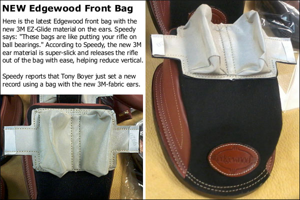

Okay, be honest. How many of you saw those EZ-Glide ears from 3-M and went “Oooo, must have those….”?
I am wondering if they make a front bag out of the same material? I would try it! Why not!! i Think there are more shooters than not that have a very poor bag set up and dont even know it. Lee
