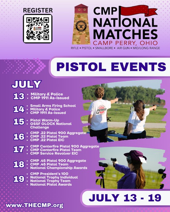

On July 13, 2025, pistol competition commenced at the National Matches at Camp Perry. Many of the best pistol shooters in the country have been on the firing lines, including members of the U.S. Army Marksmanship Unit Service Pistol team. After the last pistol match on Saturday, July 19th, trophies and awards will be presented to the top shooters.
Below is a schedule for the 2025 Pistol Competitions at Camp Perry. For more information about the National Trophy Pistol & Games Matches, visit the CMP’s Pistol Match INFO Page.
USAMU Service Pistol Handgun Tip Advice Reloading
2025 Nat’l Matches Calendar | 2025 Camp Perry Pistol Schedule

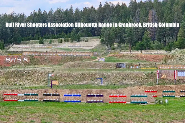

Team Lapua’s Erich Mietenkorte took top honors at the 2025 Canadian High Power Rifle Silhouette National Championships, winning the 240-shot High Power Aggregate with an impressive combined score of 195/240. Held at the Bull River Shooters Association range in Cranbrook, British Columbia, from June 29 to July 5, the national championship featured both Smallbore and High Power rifle disciplines, with competitors engaging steel silhouette targets from the standing offhand position at distances of 200, 300, 385, and 500 meters.

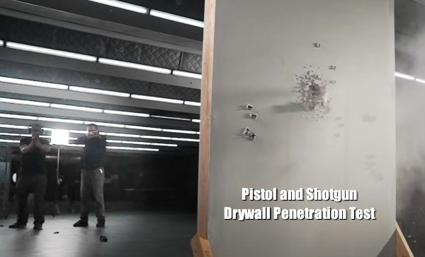

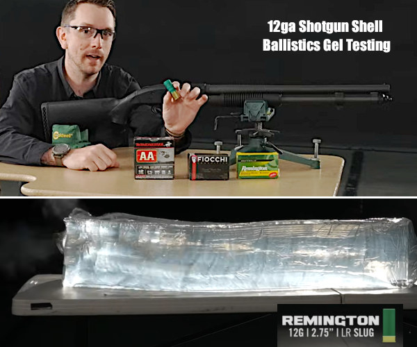

Mark and Ryan, co-hosts of the Vortex Nation Podcast, have released an informative video about gun choice for home defense. Mark and Ryan examine the performance of pistols, rifles, and shotguns in home defense scenarios. The podcast looks at the practical side of ballistics, comparing the pros and cons of these three gun types. The hosts assess the effectiveness (and penetration power) of these weapon types via field tests with cardboard silhouette targets, ballistics gel, and drywall. The eye-opening tests show how pistols, rifles, and shotguns perform in terms of accuracy, penetration power, and likely lethality.
home defense rifle pistol shotgun 12 gauge 9mm ballistic gel drywall video test movie
At an indoor range, the Vortex team tests these three gun types (rifle, pistol, and shotgun) used for protection of home and family. They run a simulated home defense scenario, aerate some dry wall for science, and hit the ballistics gel to give you the real-world testing and fun you expect with plenty of surprises along the way. Click HERE for video.
