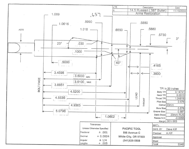

Reamer drawing in Imperial measure – http://www.elr-resources.com/wpimages/wpceecaa70_06.png
Needs an Ackley shoulder on it.
