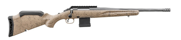

4. RUGER AMERICAN RANCH
Best selling rifles 2025 ruger american ranch camo gen 2 II

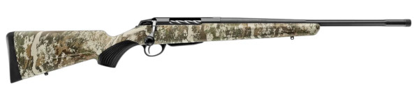

5. TIKKA T3X
Best selling rifles 2025 tikka t3-x t3x lite
