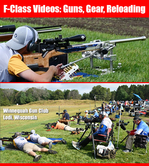

Saturday Movies: Video Showcase for 2026 F-Class Nationals
F-Open Ben Avery Phoenix Arizona F-class video saturday showcase erik cortina f-class john masek bisley f-tr
The 2026 NRA F-Class National Championships kick off tomorrow, October 25, at the Ben Avery Range outside Phoenix, Arizona. There are two divisions: F-Open and F-TR. The F-Class Championships have two segments, Mid-Range and Long Range. The Mid-Range Championships run October 25 through October 28, while the Long Range Championships commence on October 29 and conclude on Sunday, November 1st. See details of the 2026 F-Class Championships, including the course of fire, on the Desert Sharpshooters 2023 F-Class Nationals Program page.
» 2026 NRA F-Class Nationals Program (F-Open & F-TR)
For this Saturday Video Showcase, we feature seven F-Class videos. These segments cover F-Class equipment, reloading, load testing, marksmanship, wind-reading and competition.
