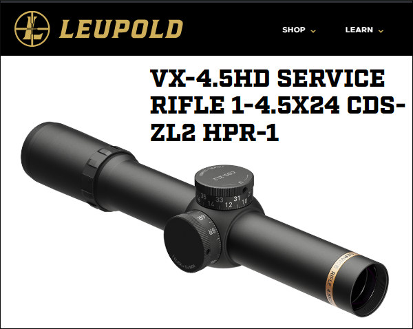

Leupold VX-4.5HD Service Rifle 1-4.5x24mm CDS-ZL2 HPR-1
leupold service rifle scope
