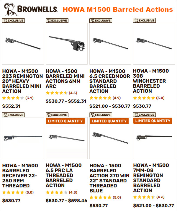

Howa Barreled Actions Are Available Now at Brownells
A wide variety of Howa barreled actions are available now at Brownells.com starting at $521.00. That’s a decent deal considering these include action, barrel, AND excellent HACT 2-stage trigger. These Howa barreled actions are offered in three sizes (Mini, Short, Long/Magnum) and with standard, heavy, and carbon-wrapped barrel types. Various barrel lengths are also offered for popular chamberings such as 6.5 Creedmoor and .308 Winchester. All these M1500 barreled actions come fully assembled with the barrel chambered, installed, and properly headspaced.
Here are some of the Howa M1500 Barreled Actions currently for sale at Brownells:
