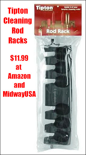

Handy Cleaning Rod Racks Are Great for Your Gun Room
Tipton Cleaning Rod Rack 100335
Tipton Cleaning Rod Rack 100335Cleaning Rod Rack Costs Just $11.99
Looking to better organize your reloading room (aka “man cave”)? Here’s a handy, affordable product that will help you organize gear in your reloading room or “man cave”. Tipton’s Cleaning Rod Rack (Tipton #100335) can accommodate up to six rods with various size handles. The wall-mounted Rod Rack also has horizontal studs on either end for additional accessories. These are useful for hanging the Tico Tool shotgun cleaning wands that stow in a tube with a plastic hook on the top.
Tipton Cleaning Rod Racks come complete with mounting screws (and screw slots are molded-in). You’ll find Tipton Cleaning Rod racks for under $13.00 at most vendors. They are $11.99 at MidwayUSA, while Amazon.com offers the racks for $11.99 with FREE shipping (#ad) with total orders over $35.00.
Another advantage of this rack is that it keeps your rods in a convenient, highly visible location. There less chance of the rod being bent or warped. Also having six handle slots allows you to easily keep multiple lengths and diameters of cleaning rods in one handy placement. This holds up to size rods with additional hangers on both outboard ends.
