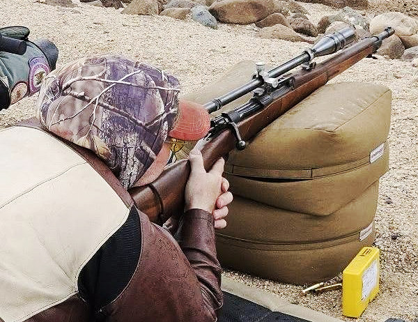

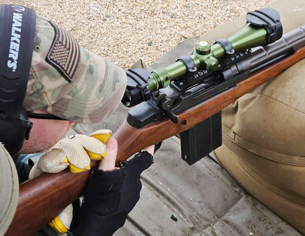

Monday, October 12, was Vintage Sniper Day during the 2026 Western Games at the Ben Avery range near Phoenix, Arizona. There was definitely NOT typical dry Arizona weather. There was some drizzle, with cloudy skies on Sniper day. This is a unique match using older rifles, with two-man teams. The team-mates take turns shooting while their partner spots and calls the shots.
