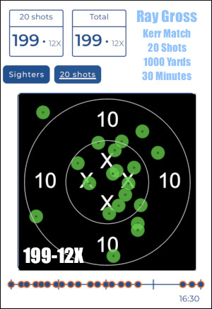

I had a successful trip to Camp Perry this year, winning the Palma Rifle division of the 1000-yard Kerr Memorial Match and winning two Golds and a Silver coaching in the three team events. This is actually my first time back at Camp Perry for Long Range since 2015. I really enjoyed my time there this year.

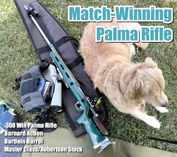

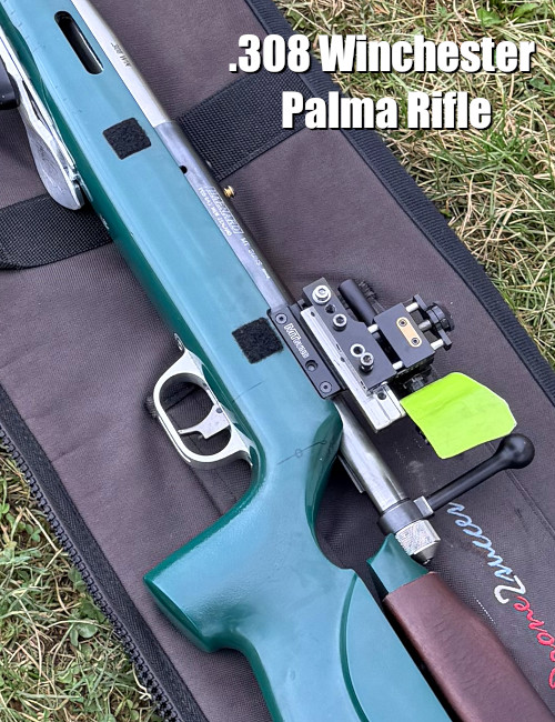

For the Kerr match, I used my standard Palma rifle. My Barnard action and Master Class / Robertson stock have been with me for 21 years now and have seen numerous barrels and a few upgrades to the stock. The stock has a bedding block and originally I had two Barnard actions that I would swap in and out. I currently use the standard Barnard P Trigger, set to 1.5 kg.
Raymond ray gross Kerr trophy winner Camp Perry .308 Win 7.62x51 palma barnard action bartlein barrel sunday gunday
This rifle has a Warner rear sight with true 1/4 MOA clicks. It is fitted with a Gehmann 530-0 rear diopter. The front sight is a Doug Beach 22mm ladder sight with a Centra 5.0-7.0mm adjustable aperture. For my eyesight (-2.75 x -0.75 in my aiming eye), I will generally run 5.1 to 5.6 on the 1000-yard target. At that size, I am more or less cutting the corners off the 6×6 target. Most of the ranges I shoot at have a large, dark-colored safety berm behind the target.

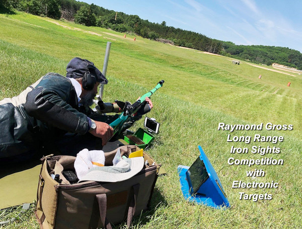

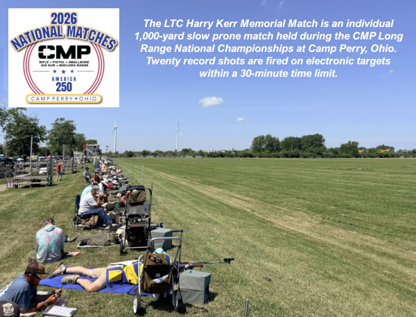

Camp Perry has a rather unique sight picture at 1000 yards, with the target surrounded on three sides with open sky, but with the dark pit safety berm below. It took a little bit to get used to that. The dark pit berm was prominent inside my aperture, even when turned down to 5.0. Next year, I plan to swap out the from aperture to allow me to get down to about a 4.7-4.8mm size.

Raymond ray gross Kerr trophy winner Camp Perry .308 Win 7.62x51 palma barnard action bartlein barrel sunday gunday target scoreThe barrel is a Bartlein 5R 300×308 Light Palma taper. Chad Heckler of 5×5 Precision chambered this barrel for me. I recently troll-posted some bore pics on Facebook of this barrel at about 750 rounds. I work at Manson Reamers primarily as a chamber designer and tech support role and get to hear many stories about chambers and barrels. I think a lot of people really misjudge what they are seeing with borescopes causing a lot of worry and anxiety. The real measure of a target rifle is how it performs in competition.

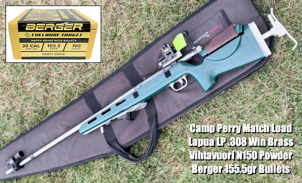

Leaving Camp Perry it has about 1500 rounds down the tube and is shooting plenty good enough to win at the National Championships. By the way, I showed up with about 30 rounds fired since the previous thorough cleaning and did not clean once while there. I am not necessarily recommending that, but this barrel shoots fine dirty.
I am on my 16th firing of the Lapua large primer .308 Win brass. I have a bunch of new small primer brass that I want to use, but the lot I have been using just won’t wear out, so I keep reloading it. My Perry ammo was loaded with Vihtavuori N150 powder, but I started the year with N140 to use up that particular jug of powder. My bullet of choice for long range with the Palma rifle is the Berger 155.5 gr FullBore Target Rifle bullet seated about .035″ off the lands. Editor: The video below provides a comparison of Lapua large primer .308 Win brass vs. Lapua small primer .308 Win brass.

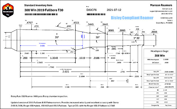

Most of my recent Palma barrels have the Manson 308 Win 2019 Fullbore T30 chamber (that I designed). That is a very widely-used chamber designed to pass Bisley Rule 150 inspection. It is a ‘Bisley Reamer’. Bisley reamers tend to have fairly long throats. I have a collection of various ‘Bisley Reamer’ prints from all over the world. The Manson 2019 Fullbore T30 is not the longest, but it is among the longer throated designs. SEE Diagram below (click to zoom):
manson 2019 .308 win palma t30 chamber reamer ray gross
CLICK reamer diagram to load full-size, downloadable .PDF file.
Since 2019 I have had a number of competitors request a shorter-throated chamber in hopes of achieving higher velocities with the NRAUK Bisley issued ammo, currently made by GGG*. The issue ammo is essentially old school Palma ammo with a Sierra 2155 seated to 2.80″ COL. The Sierra 2155 is a very accurate bullet, but it does not have the BC of more modern 155gr designs. I love shooting them at 300 and 600 yards. If you want to learn to read the wind, practice with them at long range.

The chamber in this rifle is a ‘prototype’ shorter-throated reamer designed with the help of Brandon Green and measurements of the GGG 2025 issued ammo*. The reamer is the GGG25 reamer. On the print I have a big disclaimer that the chamber probably will eventually fail the rule 150 test as bullets change over the years, but it did pass with the 2026 issued ammo. My recommendation is to stick with the 2019 Fullbore design if you plan to go to Bisley.
