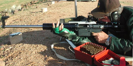

German loaded up some .308 Win loads with IMR 4320 and moly-coated Sierra 155gr Palma bullets. German’s “practical max” load delivered 2990 fps in his long-barreled Palma rifle. This is certainly competitive speed-wise.
German observed that: “IMR 4320 has very small granules and throws very consistently from the powder measure — it is very much like Reloder 15 in granule size — so for those who prefer to throw charges it’s a good choice.”
Satisfied with the chron results, German loaded more rounds with the two most promising charge weights and used them in a 500-yard prone match at Ben Avery (ambient temps were 60s-80s F). Here is his report:
“As in the chrono tests, all IMR 4320 loads were with moly-coated Sierra 155 Palma bullets, Winchester brass and PMC primers. Powder charges should be reduced at least 1.0 grain for bare bullets. The load with 45.0 grains of IMR 4320 gave me a 199-12X with the single 9 being a high shot just off the 10 ring line at 12:00. Overall, I would rate that load as good, very useable for the intended purpose of 500 or 600 yard shooting (it’s 2844 fps) but no better than my H4895 load for that purpose.
Next I fired the heavier 47.0 grains ‘practical max’ load and that was an eye opener. The score was 200-15X in conditions that were windier than those in which the first load was fired. Elevation was noticeably tighter and shots were exactly on call. This load gives 2990 fps, so it has real potential as a Palma load. While no 500-yard test can ensure results at 1000, given the MV and reasonably low SD of this load as well as the good performance at 500, I won’t hesitate to shoot it at 1000 at the first opportunity. Warning: this was a STRONG LOAD and may not be safe in your gun.
Overall, I’m very satisfied with what I’ve seen in these past few days from IMR 4320 and plan to shoot it in some of our upcoming Palma and 1000-yard matches with the 155s. It appears to be a very useful alternative to some of the harder to get powders.”
