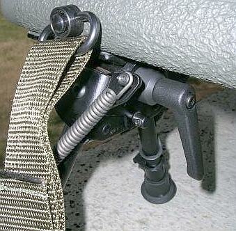

Pod-loc Harris swivelMost “tactical” shooters are already familiar with the Pod-Loc, created by Terry Cross (KMW Long Range Solutions). But varminters and our foreign readers may not know about this product, a simple adjustable handle that makes a world of difference when shooting a Harris swivel bipod.
The Pod-Loc is a “must-have” accessory for anyone using a Harris swivel-model (S-series) bipod. This unique device (priced about $25.00) transforms a Harris Swivel into an easy-to-use platform for target-shooting or varminting. The Pod-Loc cures the one major flaw of Harris Swivel bipods — the tensioning system. It is very difficult to dial out all “bipod flop” using the standard Harris tensioning knob. You just can’t get enough torque on the standard knurled swivel adjuster without resorting to a pair of pliers, and that would mar the metal. The Pod-Loc solves that problem with a short handle providing more leverage. With one hand, you can lock the bipod rock-solid, and just as easily reduce tension any time you want.
Pod-Loc
Using the Pod-Loc is easy, once you get the handle situated right. With the handle at a 4 o’clock position, the rifle should be free to swivel. Adjust the cant angle until your gun is positioned correctly for the terrain. Then just rotate the handle clockwise until you feel resistance. You can set the Pod-Loc so the rifle can still swivel a little with some effort, or you can crank the handle over farther to the left (clockwise) and effectively lock the unit in place. Once you’ve set the tension, the spring-loaded handle can be rotated out of the way without altering the tension setting. Just push the center button, pull straight back on the handle and swing it to 3 o’clock or 9 o’clock as you prefer. We advise doing this when you are carrying your rifle in the field.
Installation is a little time-consuming, but if you follow the instructions below, it shouldn’t be difficult. No special tools are required other than a pair of pliers, a flat-blade screwdriver, and a 1/4″ socket with driver. You really do need exactly the right socket however.
